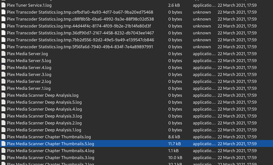

plexlogs.zip (2.6 MB)
i think i have attached my logs, ive been running plex on this server for around 9/10 months with no issues
You have zero-length logs.
Please uninstall PMS.
Verify ownership of everything in /var/lib/plexmediaserver as plex:plex (or the username you run as).
If you’re using 1.21.2.4200 – back down from it. there is a known issue with ARMv7 machines but nothng I’ve seen with i7 machines (which would surprise me)
Otherwise, Reinstall PMS and let’s re-evaluate.
