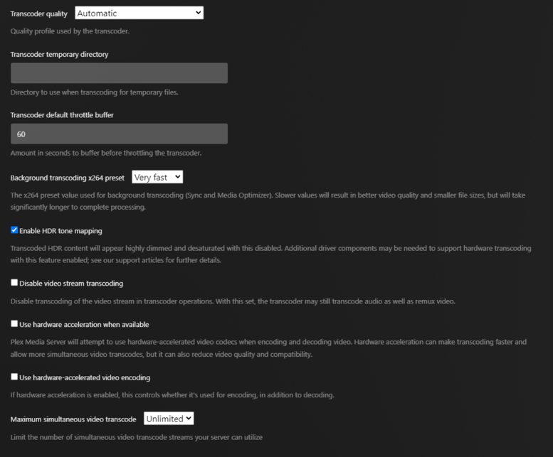

I did as @OttoKerner suggested and went into the Settings → [my server] → Transcoder, and I unchecked both Use hardware acceleration when available and Use hardware-accelerated video encoding. I still get the spinning orange circle, even after letting it sit for minutes.

  1. Given you have an E5-2650v4, much like my E5-2690v4, go into Settings - Server - Transcoding - Show Advanced
    – Turn OFF the hardware options.

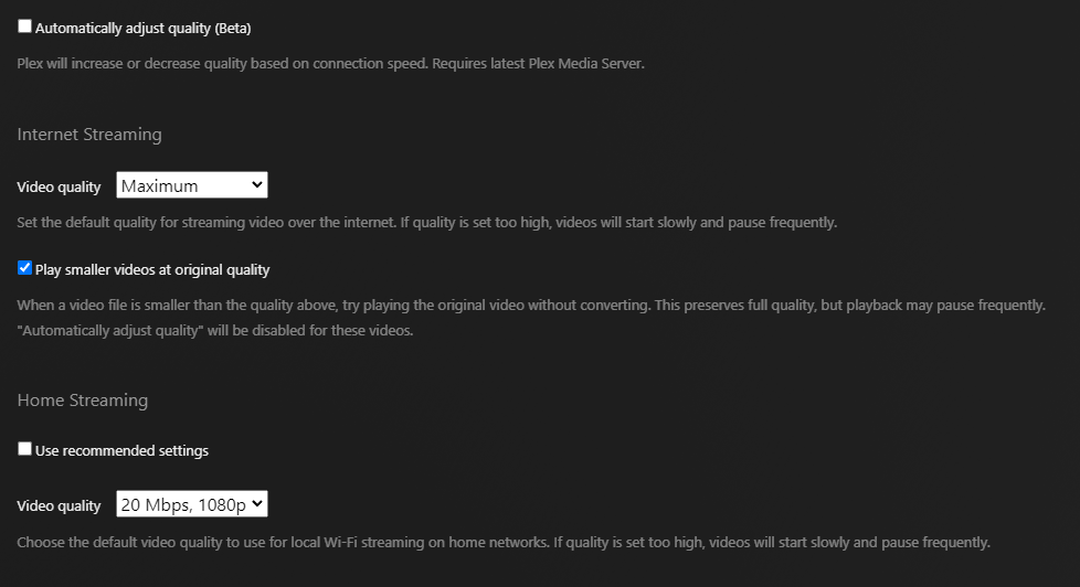

I would like you to go to Settings - Player - Quality and force it down to 20 Mbps @ 1080p
now retest.

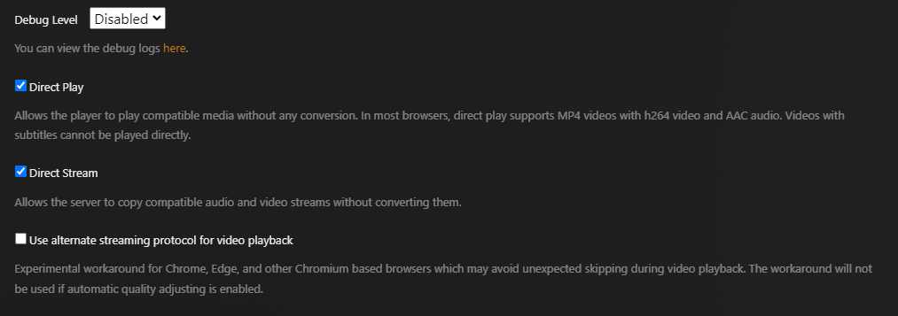

Can you tell me where the VERBOSE setting is in the player? I’ve checked Advanced settings under General, Quality, Debug, and Player, and I don’t see anything set.
I’ve made the modifications to force it down to 20Mbps @ 1080p. (it was originally at 8 Mbps) Here are all four of my current config screens for Plex Web:
General:
Quality:
Debug:
Player:

Do you have this setting for Home quality ?
I changed Internet Streaming Video quality to Maximum, unchecked Home Streaming “Use recommended Settings” and could then set Home Streaming Video quality to 20Mbps @ 1080p.
