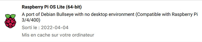

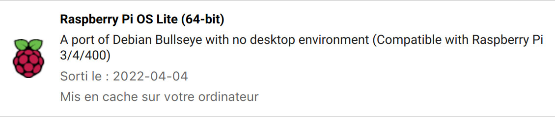

I have set plexamp on my pi 3 running :

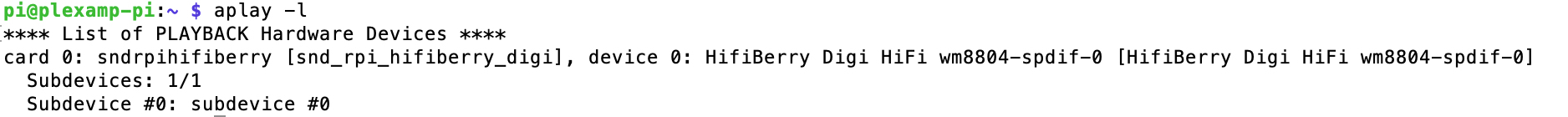

after rebooting, i type : aplay -l

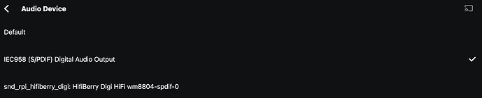

When i go in plexamp, i see the following.
Is my setup correct because i ma able to got some sound from the digi coaxial but not from the s/pdif :s
Edit : No sound from s/pdif was due to bad cable
Glad to hear it was simple (and wasn’t my fault :laughing:)
