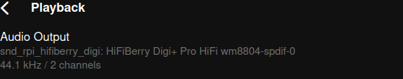

Have you gone into settings and told it to use the DigiOne?
Here’s mine as an example:
Thanks @e10kstarfire, but I already checked that.
I only have only one option: Default.
