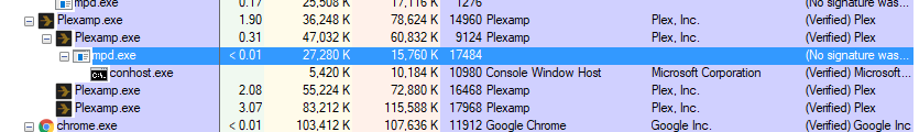

You could try to run mpd.exe from a CMD window and see if it spits out any useful information.
Found it. /user/<>/Appdata/Local/Programs/plexamp/resources/helpers
When i run it at the command line I get exception: no configuration file found.
the configuration file is in the folder with the exec.

When i run with mpd mpd.conf
it starts with
Mar 07 07:53:17.261: soundio_output: Created soundio object
Mar 07 07:53:17.267: soundio_output: Connected to soundio object
Mar 07 07:53:17.403: soundio_output: Flushed soundio events
Mar 07 07:53:17.408: soundio_output: Output device: Speakers (Jabra EVOLVE LINK)
Mar 07 07:53:17.414: soundio_output: Current output stream format: 48000:f:2
Mar 07 07:53:17.424: udp_server: Created UDP server on 127.0.0.1:36601
Mar 07 07:53:17.429: udp_server: Started UDP server.
however Plexamp still plays nothing.

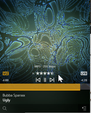

I See the error in the log.log about the .mp3 codec
Mar 07 08:06:02.718: ffmpeg: codec ‘mp3’
Mar 07 08:06:02.718: ffmpeg: Unsupported audio codec
I have stopped the program. Deleted the files in the C:\Users[user]\AppData\Local\Plexamp\Plexamp\Codecs folder for the
\6bd6751-1276-windows-i386 folder. when the program is restarted the folder is recreated and .dll repopulated. it produces the same error.

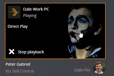

I am able to use it as a remote control to play music with Plex Media Player. plays fine. Visualizer isn’t keeping up. Then I wouldn’t expect it to with a remote sampling of the stat of the song on the player actually doing the work.
Hopefully what I am identifying is helpful. I know this is not ready for prime-time. I also know the graphic doesn’t match the song, that is not your fault.
Additional note: I found that the Plex Media Player is also using a local codec d file for MP3 playing. So I tried to copy the one that was working from the file that Plex Media Player had stored in the C:\Users[user]\AppData\Local\PlexMediaPlayer\Codecs\97a6171-pmp-260-windows-x86_64 to the same folder for the plexamp and it made no difference.
Interesting, It will play FLAC files properly.

Sorry, a few things here:
@“Jester.Tucker” — looks like something might not be working with OneDrive hosted files. If you’d like to PM me and share your cloud server with me, I can try to reproduce locally.
@Dale-Flix — the reason why it’s saying “ffmpeg: Unsupported audio codec” is because it relies on having a special environment variable set to tell it where to look for codecs. However, it does seem to start for you when run from the command line, so I’m … confused.

Okay I have final figured it out, or at least part of it. Here goes. Plexamp start up with out MPD started manually first. Some how it started and connects, to my server. The MPD that it is running is not some how finished with it’s startup.
I can start up MPD manually but when it is started it is not running with the environment variable you stated. So it can’t find the library. so If I start it up manually some how it is able to find the FLAC library it it can do it some other way. I can’t account for that.
I have been killing the manually started MPD I guess by the time I have completed 2-3 songs or repetitions, the internal MPD can be seen and talked to because then after killing the mpd I started it can continue playing for a good long while. I have listened to it most of the the day.
What I am missing is why is the internal MPD taking so long to finish it’s start. another interesting point to the findings is that if I don’t manually start mpd ahead of plexamp. the one that it is starting never starts at all. it will not play flac. I have let it sit there for up to 30 min. Way longer than my previous song list of flac and then kill and swap.
If I start the mpd manually, then start plaxamp, allow it to sit with out playing anything, for almost 5 min. then kill the manually started mpd. Plexamp again starts functioning.
I have placed a process trace on the mpd called internally. I can see based on memory consumption and ports it is listening on that is takes nearly the whole 5 min to start up. I am not running a slow system. there is no reason resource wise this is taking so long.
You can see in the server log the following entire, indicating the lack of ability to communicate with mpd after the start up.

mp3 issue due to Environment variable.
flac play,
9:04 am
one Flac song later kill manual mpd and internal one picks up and works.
