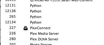

This is a screen capture from my activity monitor. All of those 4 python processes relate to PMS. Is this what you would expect to see (4 processes)?
[Capture2_zpse6a1641a.jpg](http://s72.photobucket.com/user/brett0505/media/Capture2_zpse6a1641a.jpg.html)
Yes by try it.
No idea on number of processes but my logic still holds from above.
You may want to shut down PMS, quit python processes and then restart it.
