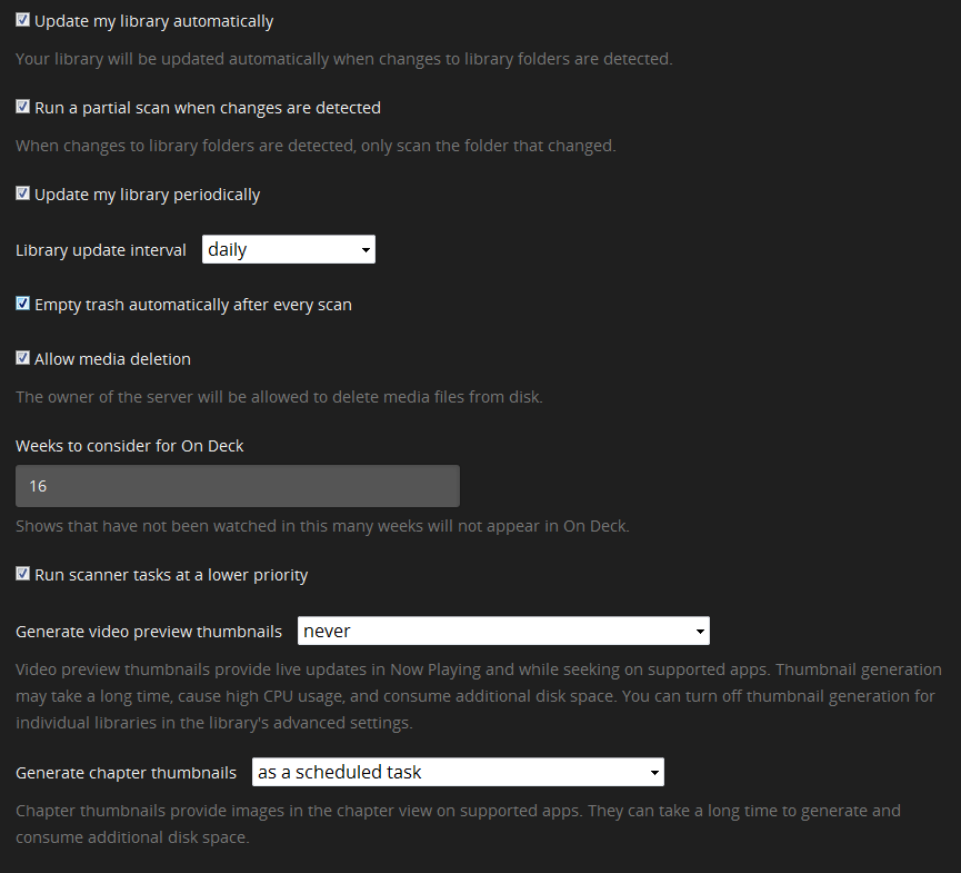

OK, so to reproduce the “daily scanning”, set the library settings like below. Use Win7, and a harddisk that sleeps after ~5min for your media. Have Plex point to the smb path (\\myserver\movies) even if the media is local.
Install Kodi with PlexKodiConnect on some client :-D. Let it do its initial sync; shut it down.
After >24-48 hours, fire up Kodi and let it do the startup sync. It should be painfully slow (#downloaded almost always = #processed) because of the PMS scanning every single item.
