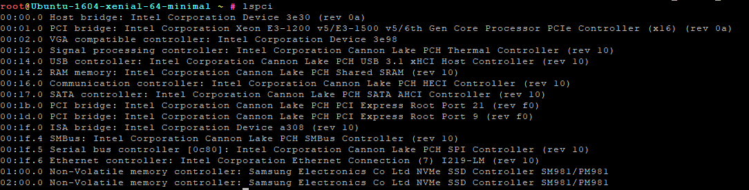

If I had that hardware, I could go look. lspci will allow you to look and see if your kernel has support for it.
Ubuntu 16.04 kernal 4.15.0
Is that what you are looking for?
