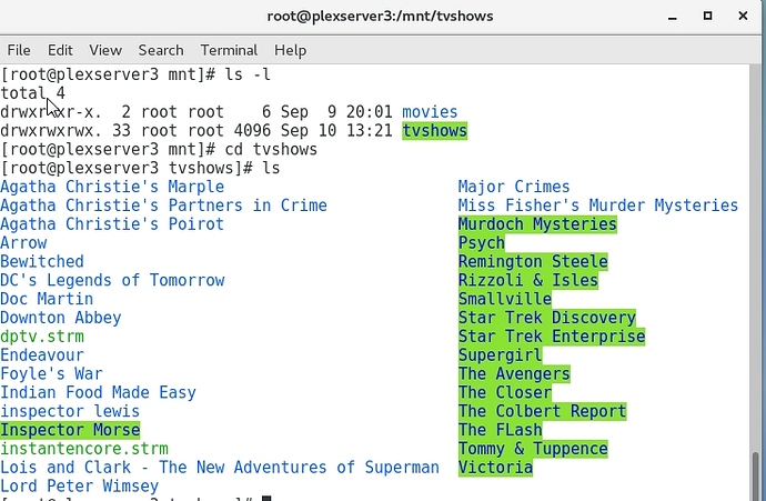

The items highlighted in green are essentially all of the items that are not brought into the library.
There is no sticky bit set on any file or folder as far as I can see. However the items listed with green background are all rwx across the board.

/mnt is 777
/mnt/tvshows is 775

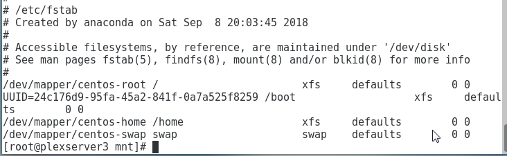

etc-fstab-on-storage
Hopefully the above screenshots provide some details.
Yes but still missing what I wish to see.
You’re showing me the mount as it exists.
I would like to see the mount itself, as specified in /etc/fstab.
You don’t appear to have this.
