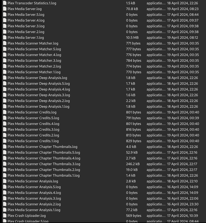

@wattsneeded
No idea what weirdness happened here.
Look at the file size lengths. ( 0 bytes ??) As if something changed permissions then later corrected them
Yes no idea what happened I certainly didn’t change any permissions (as I would probably have to research how to do that!)
At least it’s working again now.
Thanks @ChuckPa for looking into it for me

This isn’t good. Did something / someone claim ownership of the Plex shared folder ?
From your screenshot and what I have here, it looks like it.
It fails to start because it cannot write to its files.
