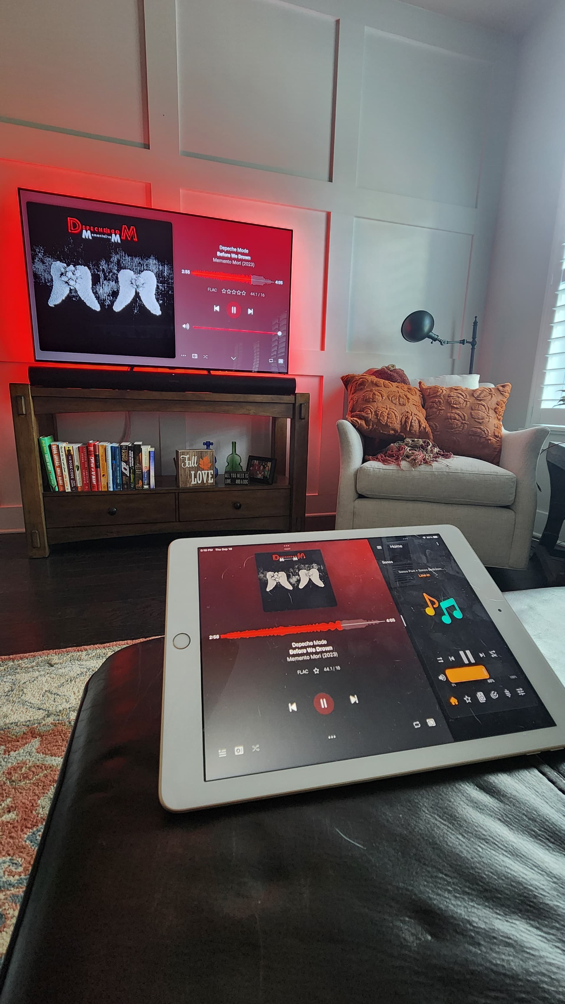

All is right with the world :slight_smile:
At least for my home plex/sonos setup.
