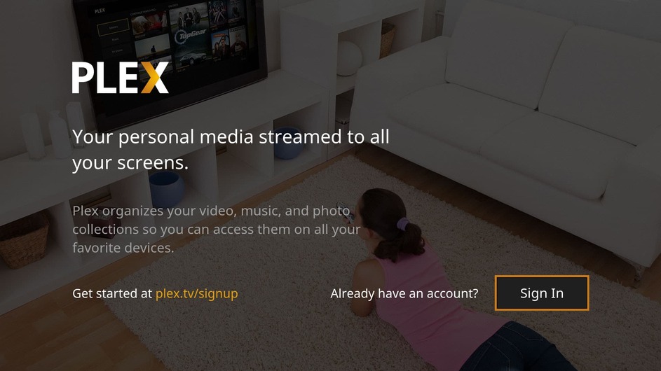

I’m facing in 0.7.9 black screen when playing PM4K, even I tried all prerelease beta but got a black screen I backed to 0.7.9-beta18 working. my setup CE in am6b+ although I did a fresh installed CE but same problem got black screen. I sent you PM the kodi log. thank you.

I also got a black screen on the sign in page. Just by clicking select the code appeared on screen in really big letters.

I’ve got the same problem with 0.7.9. On clicking on the addon, only the registration code for signing in Plex was visible on a gray background, so I went to a browser on another device, registered the code and then pm4k went on to login into my Plex account and everything went back to normal.
Mine was also a fresh install of pm4k 0.7.9., but from the zip file, since the repo still showed 0.7.8.
Also this was not my first install of pm4k, but I have uninstalled the previous version (last prerelease of 0.7.9), because i wanted a clean start for the final release.
Can confirm. Investigating.

when I open Pm4K I should see this screenshot
this problem started in since prereleases versions launched but once I backed to 0.7.9-beta18 working without any problem.
same my problem.
@aldy73 @Korbus47 @Mr_Phenix @x1ao4 please try this: script.plexmod.zip (2.8 MB)
It should fix all confirmed issues reported til now and will be the basis for the rev2 release.

I confirm after the update everything works thank you panni.

I came to confirm working in CE. best regards.
Everything seems to be working fine, pre-login screen was normal. Thank you!
