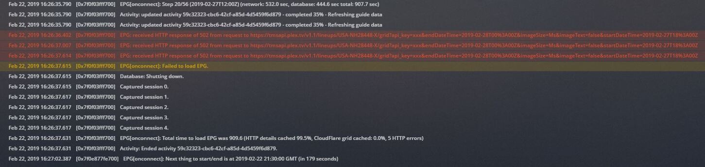

Thanks sa2000, yes, I’ll start a new thread. But the issue is exactly the same as what I was having with my Windows setup. When I removed the DVR from the Windows setup (and thus no more EPG refreshes) the crashes ended and PMS has operated flawlessly to serve media. I just can’t record with it. And now my Linux setup which I created to do the recording has come up with the same symptoms minus the frequent crashes of PMS. The image below shows the console after the most recent crash.

What do you mean by crash ? Did the Plex media server process disappear and relaunch ?
I see you are getting 502 errors - is that happening every time?
