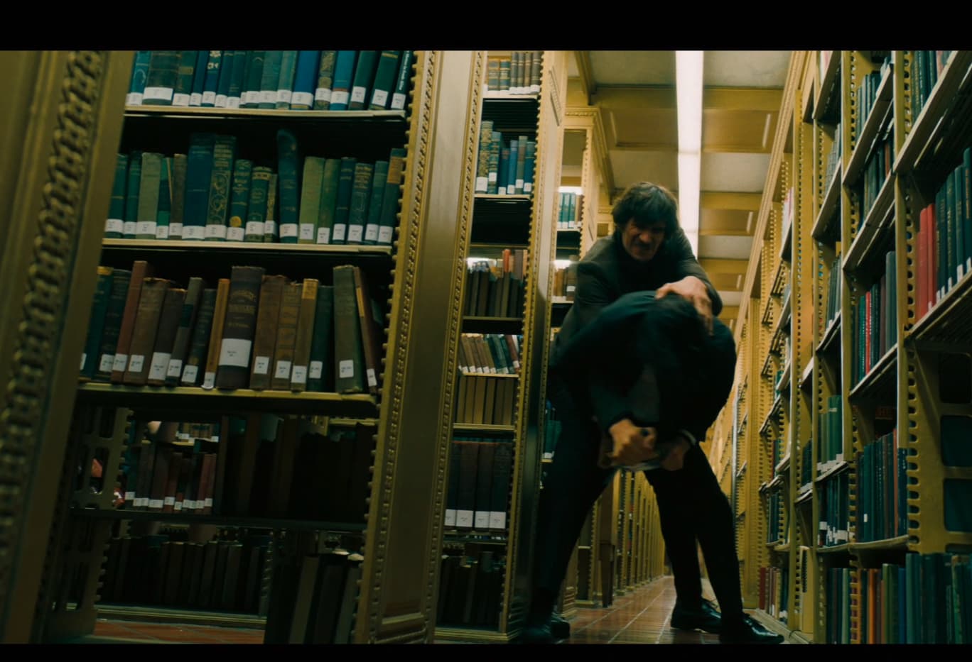

Samples of confirmed tone mapping
  1. NUC10i5FNK , 5.15.0-48 Ubuntu kernel
  1. QNAP TS-264
