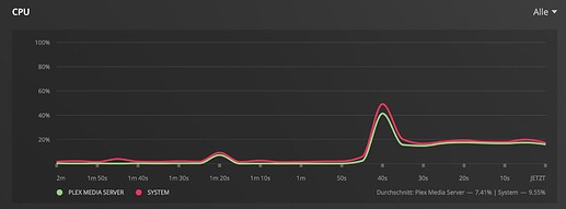

Oooooh, good to know. The issue I have is as following:
I downloaded this HDR-demo-video. Natively everything looks awesome but when I try to transcode it so 1080p SDR, the colors are super washed out despite HDR tonemapping is active.
Moreover, the system can’t keep up transcoding. It starts buffering after 1-2 min. Is a single convertion from 4k HDR to 1080p SDR too much?
One CPU core is fully loaded, so it seems that it’s not done via the GPU, isn’t it?
