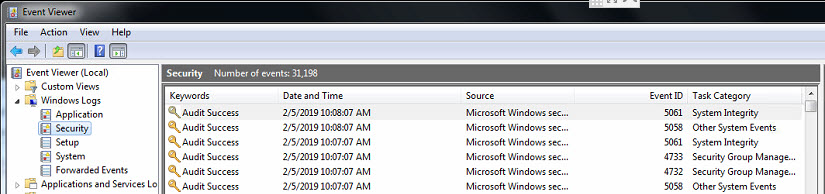

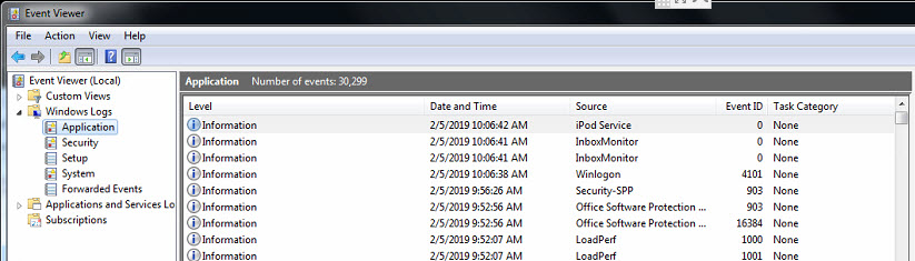

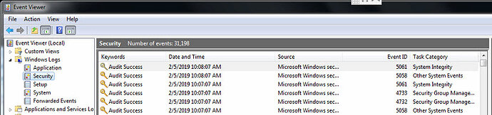

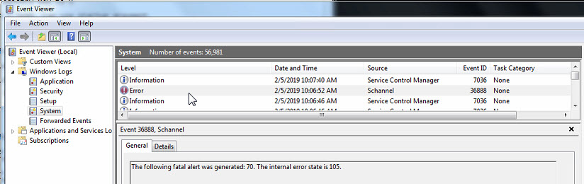

  • EventViewer gives no hint (at around the time of my tests with time stamp 10:11:00)
