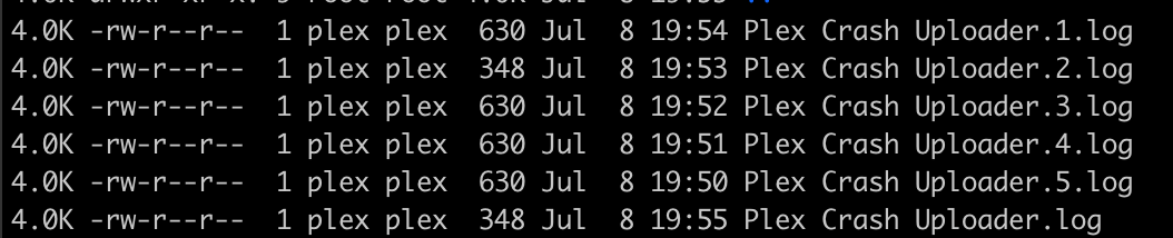

I noticed that mine crashed three times tonight back to back so I stopped the service, nuked the logs directory, then started it up again to get a clean set and here they are. From what I can tell it started with with .15 branch because if I fall back to the .14 I don’t hit this particular issue. Once this starts I haven’t found anything that seems to stop it even rebooting.
Plex: 1.16.1.1291-158e5b199
OS: CentOS 7.6.1810 all latest patches as of July 1
Here, PMS is just starting up, sees the crash dump and is starting to upload it .
There is still an active transcode waiting for data (which it starts to satisfy.
It can’t get to the DB because it thinks it’s locked
This feels like a corrupt database to me.
00294.ts (9 live) TLS 0ms 288 bytes (pipelined: 1) (range: bytes=634956-)
Jul 08, 2019 19:47:04.426 [0x7f415effd700] DEBUG - Job running: '/usr/lib/plexmediaserver/CrashUploader' '--directory=/var/lib/plexmediaserver/Library/Application Support/Plex Media Server/Crash Reports/1.16.1.1291-158e5b199' '--version=1.16.1.1291-158e5b199' '--platform=Linux' '--platformVersion=7 (Core)' '--serverUuid=17d3b7fc78dc5fc851e60e988d761dc981790949' '--userId=wilbur@wilpig.org' '--sentryUrl=https://sentry.io/api/1233455/minidump' '--sentryKey=xxxxxxxxxxxxxxxxxxxxxxxxxxxxxxxx' '--vendor=CentOS Linux' '--model=x86_64' '--device=PC'
Jul 08, 2019 19:47:04.427 [0x7f415effd700] DEBUG - Jobs: Starting child process with pid 29983
Jul 08, 2019 19:47:04.487 [0x7f40ebfff700] ERROR - Failed to begin transaction (../Library/MetadataCollection.cpp:173) (tries=1): Cannot begin transaction. database is locked
Jul 08, 2019 19:47:04.488 [0x7f40eb7fe700] DEBUG - Library item 709247 'Revenge of the Rogues' got played by account 1837080!
Jul 08, 2019 19:47:04.490 [0x7f40eb7fe700] DEBUG - We're going to try to auto-select an audio stream for account 1837080.

Just to add to what @ChuckPa said - the crash uploader log does not necessarily mean there was a new crash. If on launch Plex Media Server finds some old crash reports to upload, it will try again.
Crash reports uploading is rate limited and so not all crashes succeed in getting uploaded and a new attempt is made on relaunch.
You have cleared all the old logs and in the period covered by the new logs Jul 08, 2019 19:45:04 to Jul 08, 2019 19:47:21 there was no crash.
All there was is launch at 19:45:04 and then you shut it down a minute later 19:46:01.815 [0x7f52ca441700] DEBUG - Ordered to stop server.
and then relaunched at 19:46:04 and then shutdown a minute later 19:47:01.290 [0x7f3890bcd700] DEBUG - Ordered to stop server.
and then relaunched at 19:47:02 and logs collected
So no logs to cover a crash time
I do see uploaded crash reports - 3 from your server for these times
7th July 04:28 UTC
9th July 12:23 UTC
10th July 09:22 UTC
All to do with testing codecs. would need logs at time of crash to see what was happening
