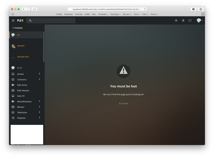

In the web UI, set up everything with defaults, adding a single “other videos” library with the single file in the above directory listing.
(Worth noting that the above image is a link to an album of screenshots, not just a single image.)
After this interesting result, shut it down:

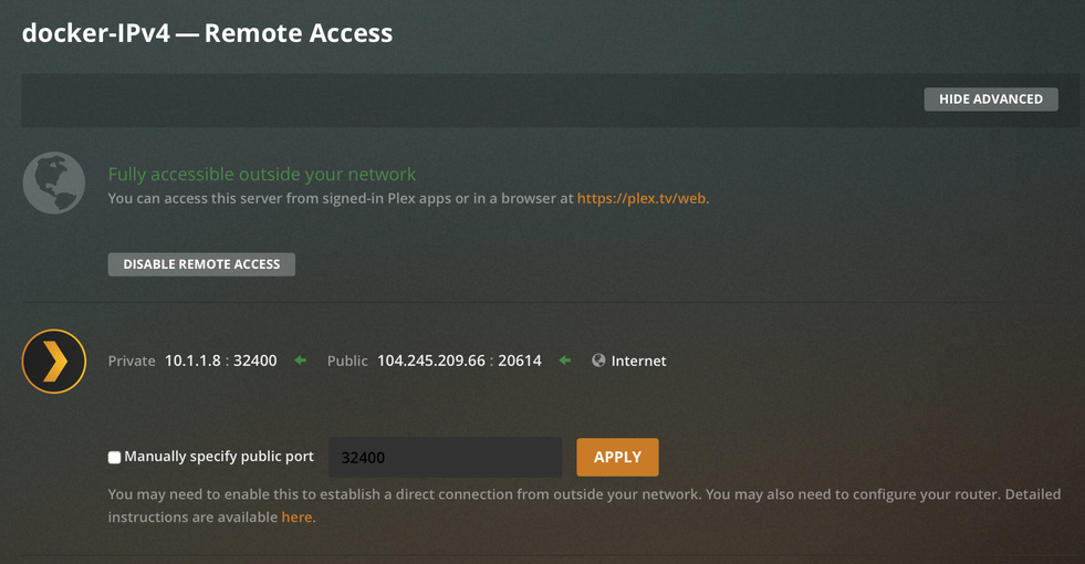

For completeness, I built a completely fresh Debian 10.2 VM, installed docker-compose, and put the compose file and a single video file in place. Agains, as simple as I could get. Failure. Something is very wrong with the Plex container.
(Also gotta love those phantom old Docker servers showing up on the sidebar, even though I’ve removed them from the Authorized Devices and deleted the servers themselves.)
