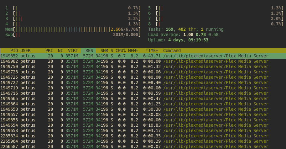

The memory still continue growing. Around Monday, PMS’s memory has increased to 1 GB. As you can see the screenshot on Apr 12, the PMS’s memory was only 572M.
But unfortunately I don’t have screenshot or data now, because I accidentally unplugged the server power at that day, PMS have been restarted all over again.

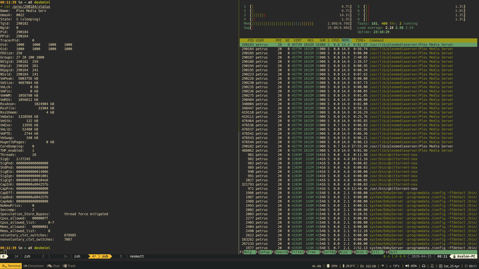

It’s been a week. I collected some data in these two days.

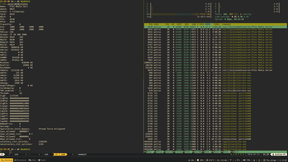

Let’s see first screenshot.
In this screenshot, you can see the uptime is 9 days. Last time I said I accidentally unplugged the power, the uptime begin with this exactly day. During those 9 days, I didn’t use plex at all, but even though the memory of PMS still grows to around 851M.
The reproduce step is easy:
  1. Setup live TV
  2. Click ‘Live TV & DVR’
  3. Click ‘GUIDE’
  4. Play live TV channel.

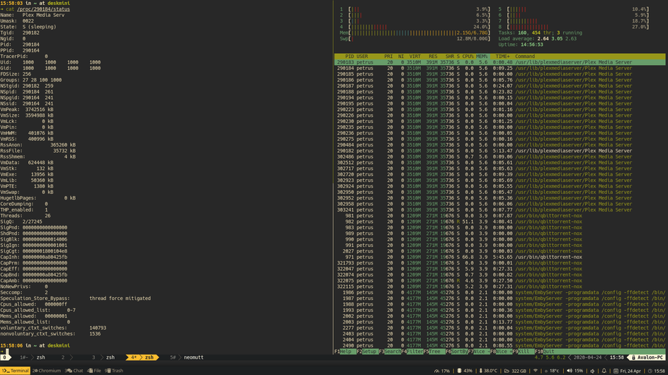

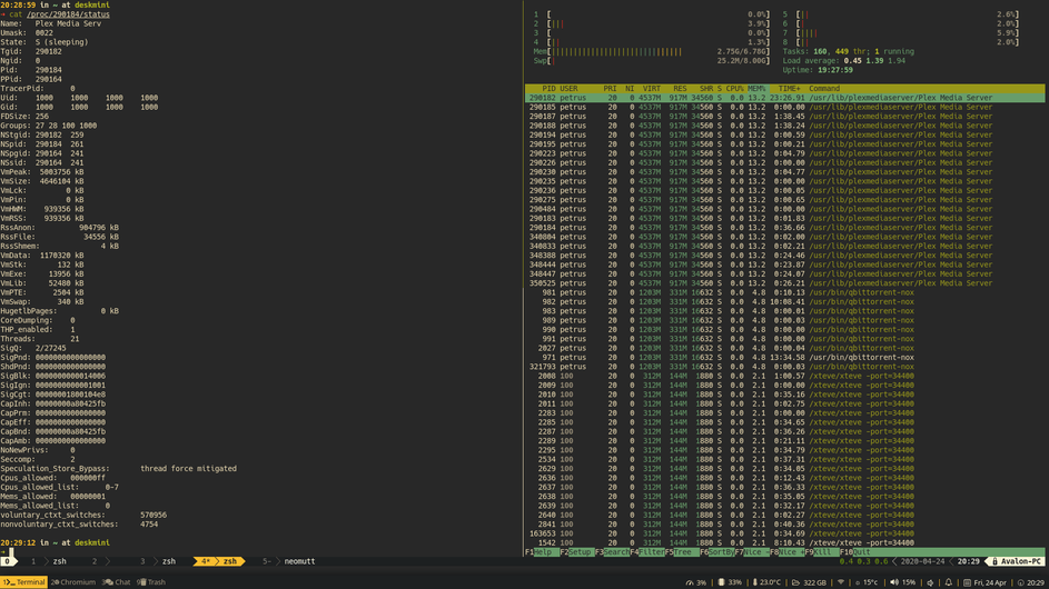

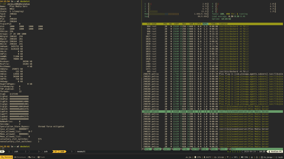

Next screenshot, in this screenshot I restarted server and PMS. You can see in this period, the memory usage was very low.
Note: in this screenshot, the uptime is around 13 hours.
In this 4 screenshots, you can see PMS’s memory usage is gradually growing. At the last screenshot, the uptime is 23 hours. The test begin with uptime 13 hours, after 10 hours passed, the memory usage become around 1 GB and never free them once (from what I can see).
