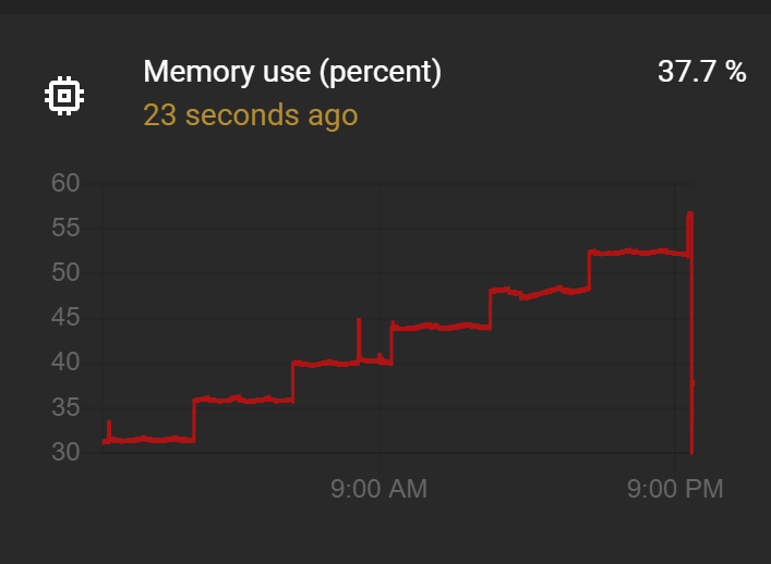

My plex is almost always idle, and this is its memory consumption :open_mouth:
have the same issue on my ubuntu system with plex running in both docker and on the host
the drop happens right after i restart the docker container
