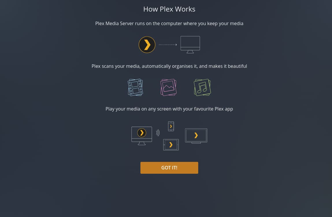

First, please do steps 1-4 and let’s evaluate the status at that point.
What now?
Click the “Got It”
The setup wizard will start in that same wizard.
You create one small library section (pointing to specific media-type folders)
Make any settings preferences you wish that it presents,
When you Finish, you’ll arrive at the dashboard.
You’ll see your server completing the initialization and ingestion of the media.
We’ll watch for failure.
