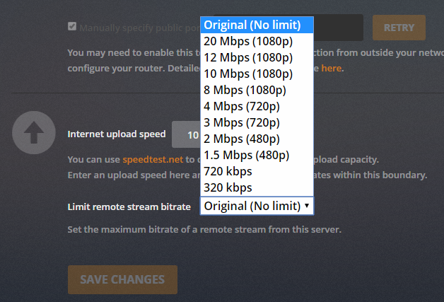

Are any of the devices remote? If so, check Settings -> Remote Access -> Internet Upload Speed and Limit Remote Stream Bitrate.

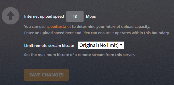

Under Remote Access, its set to Original and nothing is limited. Do you think they are transcoding due to something on the clients side? this is mostly my family accessing from different states so i can’t really check their settings but im shocked it would drop down to 328p.

where is this?? Settings -> Remote Access -> Internet Upload Speed and Limit Remote Stream Bitrate.
on client or server side?? if on server side I dont see that
Server. 2nd item in Settings, between General & Agents. Login to PMS via Plex Web or Plex Media Player. Server settings are not visible in Smart TV, mobile, etc clients.

I must be blind.. This in on the server side.. but dont see the setting you are talking about
My bad. You’re not blind. It is a Plex Pass feature. I previously checked the Plex Free vs Paid page, but not the Remote Access documentation (where it is mentioned). Apologies for the mix-up.

yea i double checked all my settings. no idea why sometimes my dads showing streaming at full resolution and other times it transcodes down to 480p. weird,
