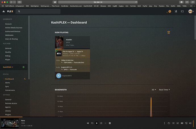

Hello. I’m wondering why my server is transcoding a file to a remote location, that shouldn’t need transcoding. My friend is sharing my libraries, and he is streaming the files in through an Apple TV (non 4k), to a Dennon receiver with a 5.1 audio system. He has a Samsung Smart TV, less that year old. I’m sorry I don’t have all of his exact model details, but I do know that he should at least be able to stream a movie at higher than 3mbs, and get at least 1080p.
At first he had his internet streaming setting set to super low, and he was having stuttering issues, along with an eventual, “the server is not powerful enough” message. I told him to set everything to maximum, and that my server should then detect what the highest quality allowable for him to stream would be. Yet after changing his setting he’s still only gettin 720p and transcoded audio. The files are playing fine now, but why isn’t he able to stream at a higher quality?
Am I wrong in this assessment? Is there a setting on my end, or on his end, thats keeping him at a forced trancdode level and 720p?

This is ALL dependent on his ‘Remote Quality’ setting.
Typically he’d set that at 80% of your upload bandwidth - or his download bandwidth.
The ONLY Server option you have is to limit an individual stream - so make sure you aren’t:
Server/Settings/Remote Access
Give it 80% of your total upload bandwidth at the server
and make sure you aren’t limiting an individual stream, or limit it higher than whatever it is now.
Also, if he has an option in his app to ‘Adjust Automatically’, or ‘Auto Quality’, for now you want that off, but it may help you once you figure out what’s going on.
