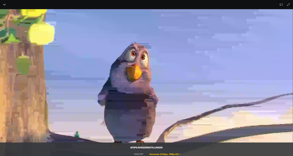

I have Qnap TS-251+ nas and plex server running on it.
I bouth plex pass to be able use HW transcode function.
It works well with low hw resources, but in case of low bitrate 1080p movie , the picture quality is very bad.
With sw transcode the picture qualiti is same like the original.
But with hw transcode , the picture is checkered, blocky.

For example a 2.9 Mbps 1080p content, with plex, is provide worse quality than SD movie with DLNA.
Is there any chanse to develop a switch into the transcoder settings , to use sw trancode when the bitrate lower than 5 Mbps?
Or something like that? If this quality issue can’t be corrected in the hw transcoder?

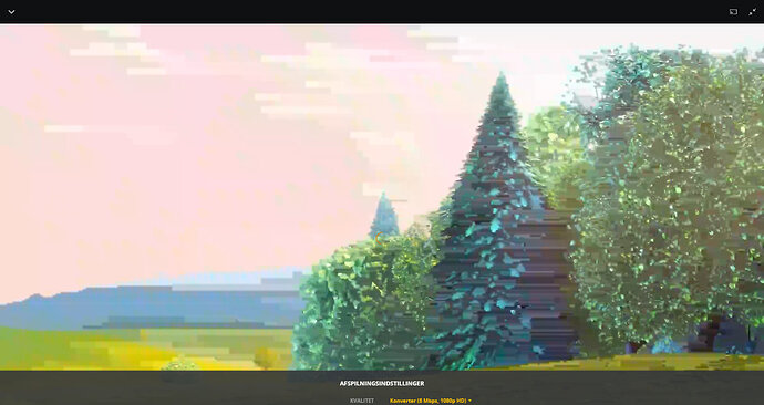

Can we await a picutre quality improvement during HW transcode? Because yesterday i saw the same blocky picture during 12 Mbps 1080p video. This is unacceptable . I paid for a feature what is unusable.
