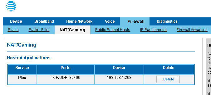

I’ve got att fiber and my plex works great outside of my home. Streams full 1080P as long as T-Mobile can handle it haha. My PC (Plex server) is connected directly to the fiber modem (Arris BGW210-700). I set my computer to a static IP from one of the dhcp ones that att gave me with google dns 8.8.8.8 and 8.8.4.4. Windows Firewall is off. Added nat rules in the arris modem (See pic).
