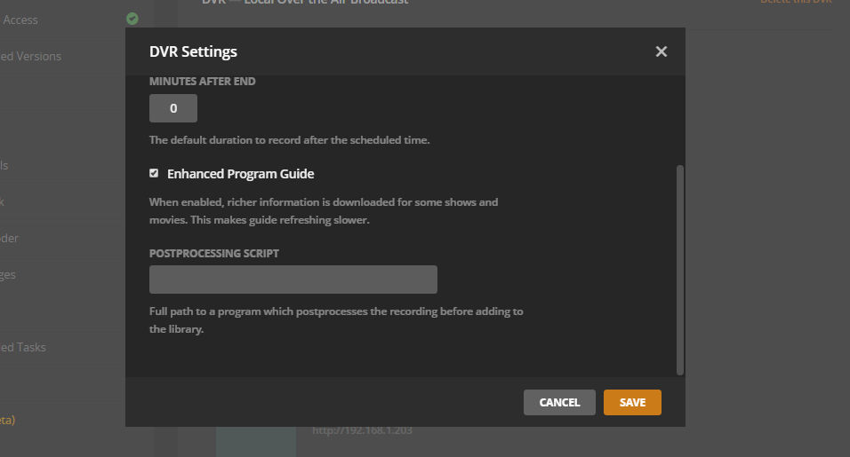

Then go to Settings -> Server -> DVR (beta) and select DVR Settings
Scroll to the bottom of the popup screen and enter the path & file name of the above script into the field for POSTPROCESSING SCRIPT

Got it. So I pasted the following in. Any way to confirm it was taken properly by Plex?
curl --header "X-Plex-Token:MYPLEXTOKEN" -X PUT "https://MYIP:32400/livetv/dvrs/MYDVRID/prefs?postprocessingScript=/data/plexdata/Scripts/plexdvr.sh"
Btw I replaced the following variables:
X
MYPLEXTOKEN
MYIP
MYDVRID
You don’t have to do that curl command anymore if you are on the beta3.
It is in the DVR settings screen now
So all I need is to paste the following path?
yes
