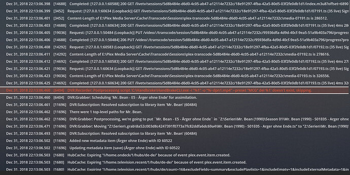

Hey guys. Im trying to do the same. Just converting the TS video file to mp4 h.264 to save some disk space.
Plex always gives me the error "not found when i try to use the script:
C:\Handbrake\HandBrakeCLI.exe -i “%1” -o “%~dpn1.mp4” --preset “MCG” del %1
So i try to convert it manually after copying the video file to the handbrake folder.
I get this error. Can somone help me with that please?
