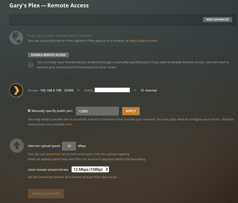

I am running my plex server on a windows 10 machine. The server and player are on the same machine. I am running the Private Internet Access (PIA) app to manage my VPN. I Have the standard port forwarded on my router (32400). Without PIA running my server is available when I check the settings page and I can confirm access with my cell phone off wifi without the VPN turned on.

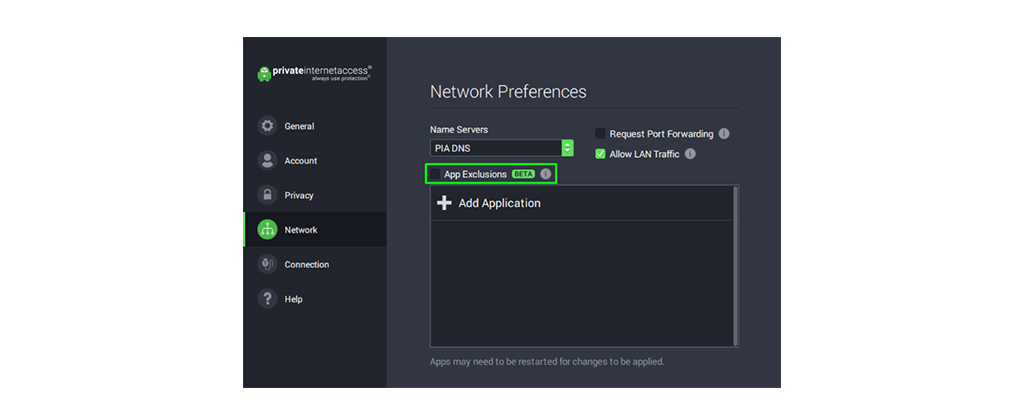

I have added plexmediaserver.exe to the exceptions list in the PIA app.
When I turn the vpn on, I can still use the plex media player app on the same machine, but my Plex Media Server is no longer accessible outside my network (confirmed by using my phone off wifi), in fact the settings page will not load/refresh on the server page in the browser on the server machine. I restarted my router and my PC. Still not accessible if the VPN is on. I tried changing the port on my router and plex to match the port forward provided by PIA from the PIA app. Still not visible to the outside world. I tried accessing the server using my local IP, the VPN IP, and 127.0.0.1 in the browser. Still could not get the settings page to load.
I also tried adding the link from the start menu for Plex Media Server as well as every .exe in the PlexMediaServer folder to the exemption list, which made no difference whatsoever.

Making sure Plex was back up, local and remote - with my non-standard forwarded port (5 years old - ain’t broke, don’t fix it).

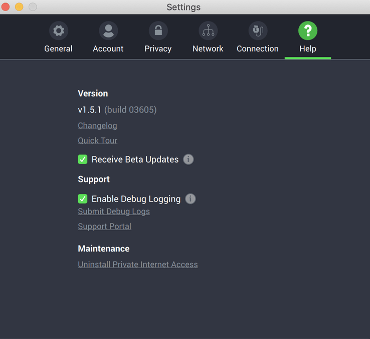

Anyway there were a few issues with Plex that had to be resolved, Version 1.5.1 was released and Plex could gather Metadata again after a few Beta testers reported an issue. Yes I was one of them. The current Version is the result of Beta resolutions. I tested the PIA app for MacOS.

I have 1.5.1

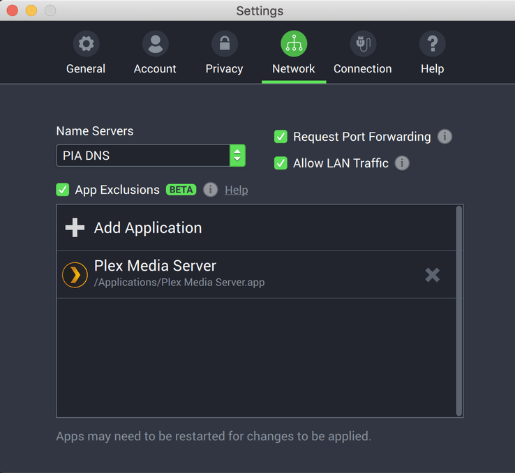

Working fine here, using the Vancouver server.
MacOS Catalina
Server: 1.18.2.2015
Yep, Vancouver, Green Check, but:

Select Add an exclusion , and then select from files, folders, file types, or process. The exclusion will apply to subfolders within a folder as well.
Not sure an exe will cover it
and what exclusion(s) should I add to get settings back?
This is important info… not immediately apparent to Average User Joe (Juice).
Not a windows guy but all files obtaining to a PMS app I would gather. What i remember from many light years ago, in a far away place, don’t apps in windows have a Master folder. Visible in Icon view
Wow, Man - That could be a host of one file - or millions.
As it stands - this is more of a PITA than it’s worth - for the short intervals the server will be unavailable while the VPN is on.
What did you exclude - or for you was it just automatic?
On mac apps have all it’s files in a single folder with sub folders. So as you see one Master app folder.
