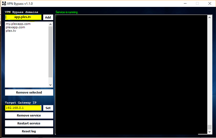

Install it and run it
You will get to this screen after you open it
Notice The highlighted areas…
In the top one you need to individually add
my.plexapp.com
plexapp.com
plex.tv
app.plex.tv
You may also need to add these addresses that Plex changes randomly. This is a link to their list from the Remote access trouble shooting page.
Plex IP Links
In the next one labled Target Gateway IP you put in your Router’s IP address.
Then you click restart service after it turns yellow for update.
