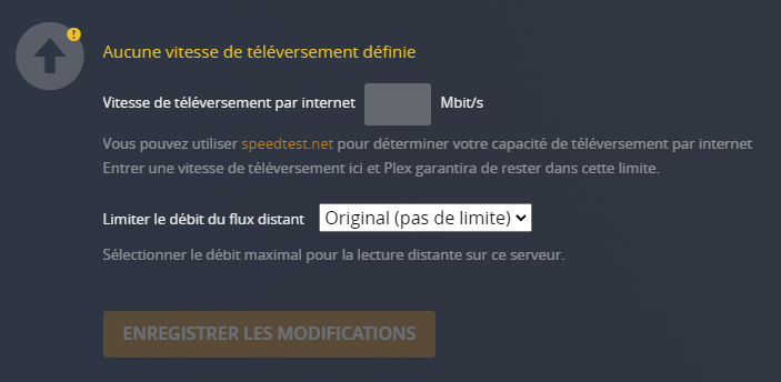

Voici mes paramètres actuel pour le transcodage :
transcoding
Y aurait-il un paramétrage de transcoding que j’ai raté pour optimiser tout ça ? Est-ce sans espoir (à moins d’upgrader le CPU) ?
Merci d’avance pour votre aide précieuse
which settings are you use for local and remote connections?
Hi Serge. Is that what you’re looking for ?

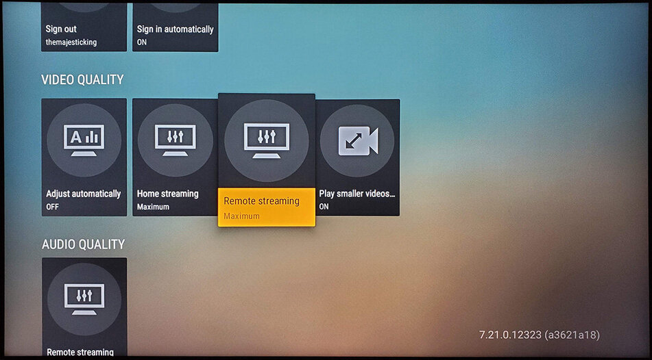

these settings are on the plex client side

find these settings
Which client are you using ? I have never seen this GUI
it is android
which OS you have?
I’m using Plex 8.29.1 on Android with my Samsung S9. This does not look like this at all
check QUALITE
what is inside?
Looks like I can’t do more to have best quality
i do know not french(((( but make settings to max
