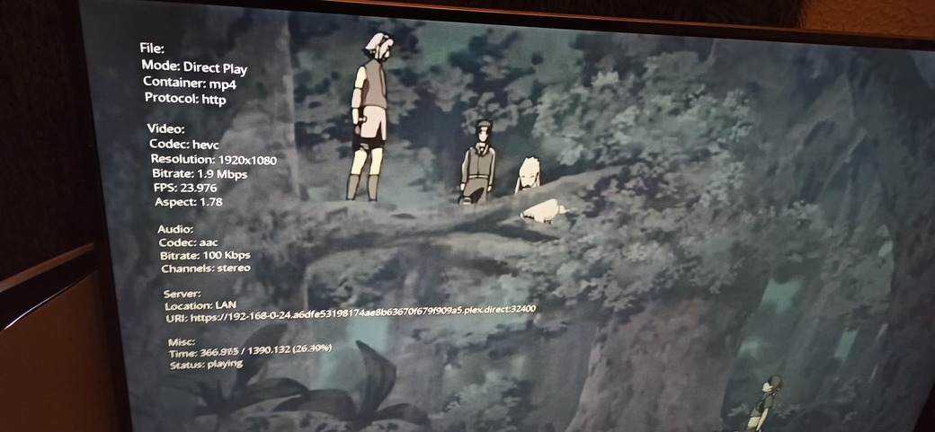

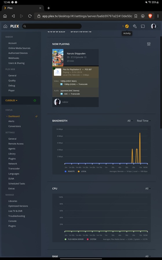

PS5 seems to think that it is using a Direct Play http protocol, however, the Plex Server says it is transcoding from HEVC to H264.
Despite this, playback quality is pristine, smooth, and there is zero CPU load on the server; suggesting that the video is not being transcoded.

I’ve also noticed that if the PS5 decides to use Direct Play protocol dash, then it switches to Direct Stream instead, and this is reflected on the Plex Server.

Can you post a screenshot from the dashboard?
Uploaded in edit of original post xxoo
