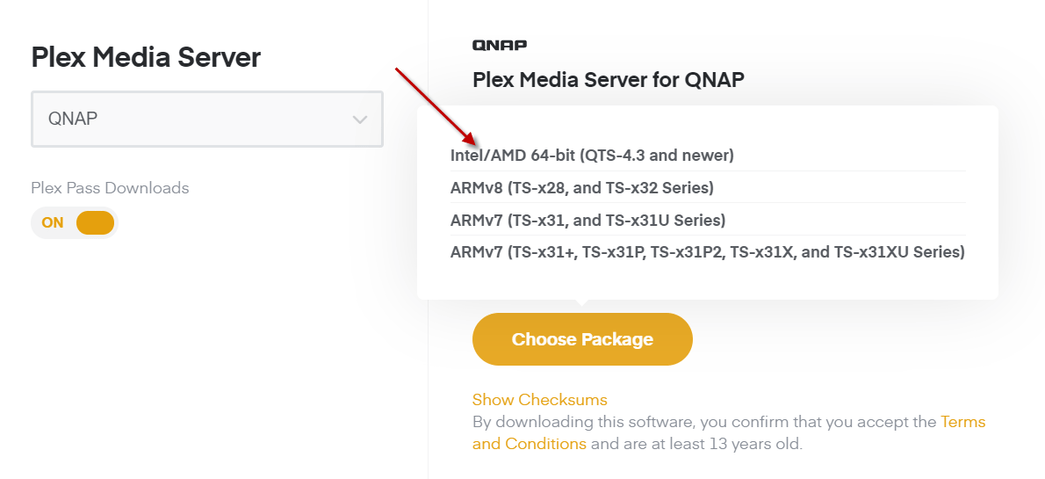

My PMS on my QNAP is currently running version 1.9.6.4429 for the 32 bit QTS 2.5. It says that there’s a newer version available but cannot find it.
1.19.2.2673-776106bc6
It shows a 64 bit version for QTS 4.3 but the last time I updated to the 64 bit QTS my Plex server wasn’t found!

The lowest version supported is QTS 4.3 due to the GLIBC requirement in PMS 1.15.0 and above. GLIBC was updated a bit from the ancient & archaic to 2.14.1. As reference, most distros are now running 2.28 and higher.
