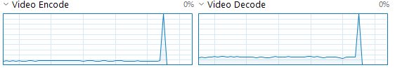

In addition to the previous info, I can see that the GPU is (should be) both encoding and decoding…
I had a transcoding going and then stopped it… both went from 8-9% to 0%.
