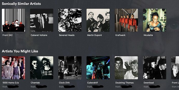

when it was not working I didn’t see “artist you may like” like you can see here
Yea indont have that I have similar artists and sonically similar artists.
So i was able to get access to another persons library. At first radio didnt show anything but now i see this new users songs in artist radio. Also i am seeing artists you may like from their server on the plex web home page.

If you see “Artists you might like” populated with items from the shared library, then the feature works.
