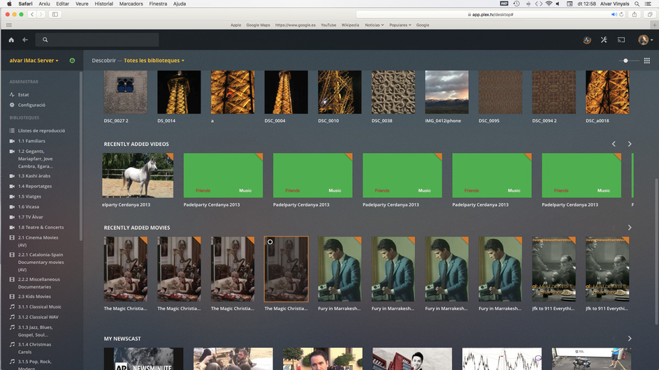

Does anyone knows why I get 4 thumbnails of each film or music file? How can I  solve this withot the risk of deleting the file?

From your description, there are several possible reasons.
Please post some screen shots (full screen!), which will make it easier to determine which it may be.
Thanks so much Otto for your Quick answer. I include the screenshot. I’m really happy that after months struggling with the app, I finally succeded to run the server form My Cloud Home.

Please, please don’t answer per email.
Your email footer is cluttering up the thread and the screen shot is so small that I cannot discern anything on it.

I see you have several libraries of each type (‘Other Videos’, ‘Movies’)
For a start, please edit each of your movie libraries,
go to the ‘Add Folders’ tab
and note down how many and which folder paths are listed there.
This will tell you which folder each library is “looking at”.
If two libraries are looking at the same folder, they all will add a new file in this folder.
This will then cause the newly added file to appear in several libraries, which in turn causes it to appear several times on the front page.
Please report back with this list.
