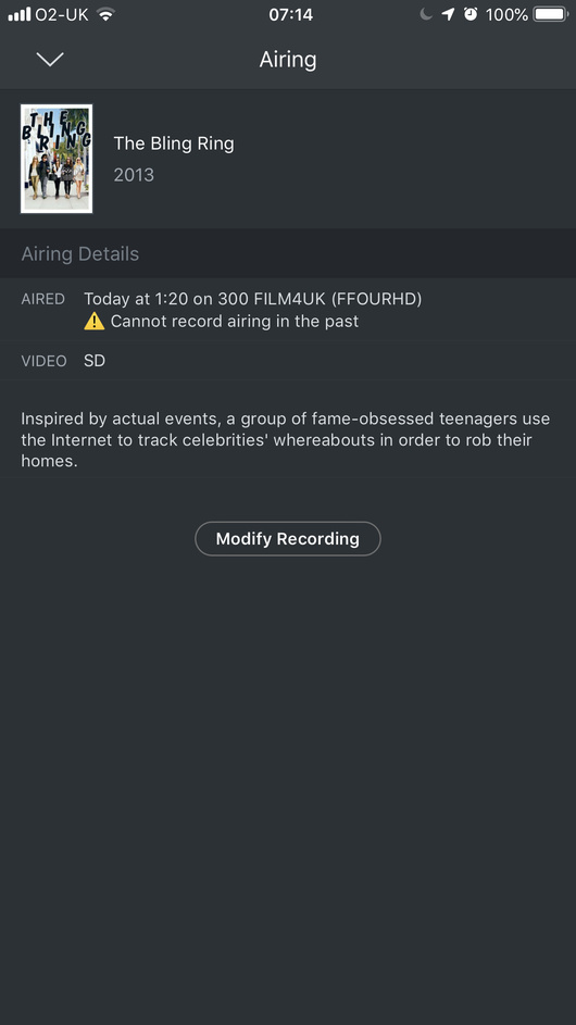

I noticed - for the 2nd time now - that a recording failed with the message:
“Cannot record airing in the past”
It had been scheduled for 01:20 GMT on channel 300 FILM4 UK
I have attached full set of logs:
Plex Media Server Logs_2019-03-12_07-15-56.zip (4.3 MB)
Here’s a screenshot showing the error:

I’m recently getting this error as well. The error message itself is not particularly helpful.
I’m trying to record just the first 50 minutes of a 3-hour show so I have entered a -130 to the Record Minutes After End parameter. Show used to record and now, somewhat randomly, it does not.
