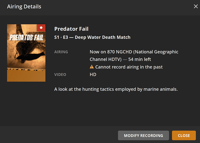

1 random one is if I schedule a recording every 3rd or 4th recording once the show has finished I get an error saying “Cannot record airing in the past”

Recording scheduled a week ago, all eps new & old, via web ui on PR4100
There were three eps airing in a row today, first two recorded without issue. The third failed as you see.
