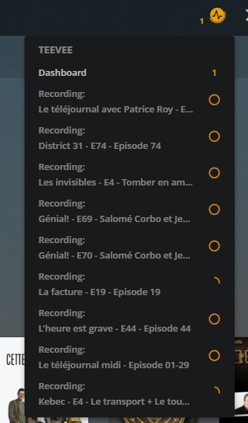

I’ve been using the DVR functionality for a few weeks now. There’s a rather annoying issue that comes back every few days: One or two recording will hang at 100% (even if transcoding is disabled) and will never complete unless I restart the plexmediaserver.
I see a bunch of folders under “.grab” but they are all empty. The recordings don’t appear under their respective folder either.
From the screenshot below, there are recordings that were completed more than 24h ago.

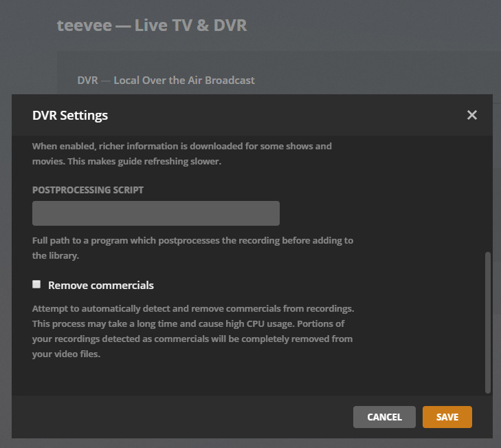

Btw, I just want to re-iterate that I’ve not enabled transcoding or commercial sklpping.

Are you using commercial skipping? The only time I’ve seen this kind of behavior when plex commercial skipper is being used and it’s hung…
Nope!
Nor do I use transcoding:
