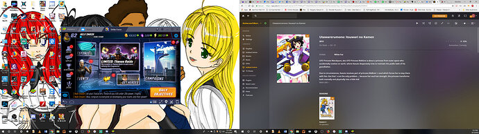

Hey @ZeroQI I have something weird going on. Utawarerumono: Itsuwari no Kamen [anidb-11272] is coming up as UFO Princess Valkyrie [anidb-160] even after matching the exact title to correct it. Is this something going on with Hama or Plex? com.plexapp.agents.hama.zip (523.1 KB)

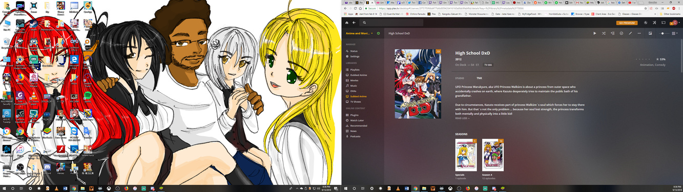

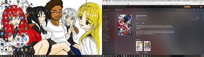

It has also happened in high school dxd

mapping list find tvdbid 79880 then assign 81477… Bug in the AnimeList mapping part, possibly due to an anidb id assigned to a multiple season series which should be assigned a tvdbid OR move from season 2 the eps to season 1. Will have a look at the code latter

i reproduced the series you mentioned.
when assigning an anidbid on this series while files are in season 2 the bug appear
I corrected it so while it will have the right tvdb id:
