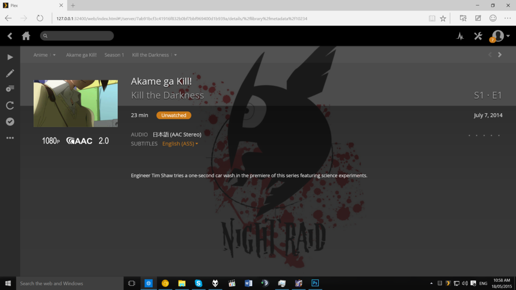

I have a weird issue, synopsis metadata isn't acquiring for episodes that actually have metadata, and garbage metadata is taking its place. Newest agent, BABS.
MAL
http://myanimelist.net/anime/22199/Akame_ga_Kill%21/episode/1
Plex
http://i1292.photobucket.com/albums/b568/FireFreak111/Screenshot%20360_zpsuicjh9dx.png~original
Also, to solve the empty season images problem, is it possibly that the cover art could by used for the season art too? If it ends up acquiring 2x the files, it wouldn't be worth it, but if the same images could be used for both, it would definitely help the look.
I am asking on the forums if its possible to help contribute episode metadata to help out, if it works out I might spend a decent amount of time focusing on the most popular/top anime and adding episode information to them. If it doesn't, I'll live with what MAL currently has as they likely add it at their own pace :).
Update:
Redid the library/wiped bundles, cache etc for myanimelist and its all sorted. There is no synopsis for any of the anime, and no episode descriptions, even if MyAnimeList has one. Is this intended?
Hello,
I receive Episode Data from TheTvDB not myanimelist because a few weeks ago myanimelist didn't support Episode Data. The second reason for it is that with every additional Information from myanimelist I need to do a separate request which will be endless the more episodes are available and there is no way to shorten it. So no Episode Description, Sorry.
I noticed that there won't be any synopsis since they updated their page. It seems the date aren't parsed correctly or isn't found.
I will look into it, also I thought about a major re-factoring of the API. Need to think about a way to get the episode data only from myanimelist without making a bunch of requests for each anime.

It's good to hear the synopsis isn't a fundamental issue or anything like that. Episode list's aren't a rush, because a huge amount of anime still don't have a list on MyAnimeList (as you said, its new).
Is there a reason garbage metadata like that gets inserted if I select TheTVDB alongside MyAnimeList in the Agents section? All the episodes in my anime have Fire and Water metadata from National Geographic when I add it, and only deleting the library and cleaning the bundles/cache removes it once its there. In the past, I have had this issue with The Inbetweeners taking Fire and Water's place.
You've done great work so far, allowing larger anime collections with less popular anime to have metadata. Thanks. :)
Don't activate TVDB alongside the myanimelist agent. It does weird stuff so just deactivate the contribution.
