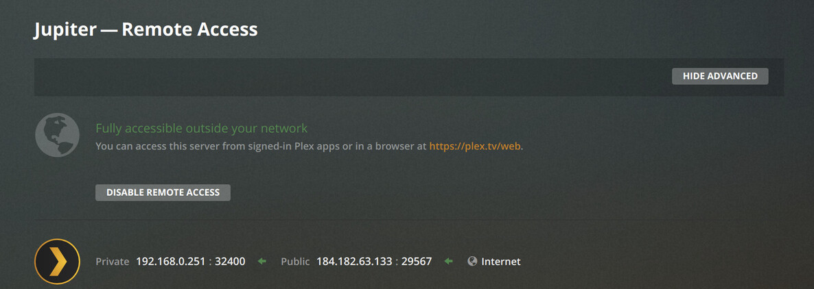

Ok, not riddle me this batman - I’ve turned off my Deluge Docker image as I’m not using that and I’ve turned off my PIA VPN. Yet still, I see:
184.182.63.133 is the IP address of my router. If I disable then re-enable remote access I see:
That stays or sticks until I refresh the web page and then it goes back to the first image. Ugh, why is this so difficult and unreliable? Why is it Plex can say “Not available outside your network” when it’s clear that it is available outside my network! When this says “Not available outside your network” I can use my cell phone on my cellular data and connect and play stuff from my PMS! And it doesn’t say indirect it says remote. Yet in the server config, it still says Not available outside my network. Isn’t that a bug? Isn’t that wrong?
Additionally, I can go to canyouseeme.org and it says port 32400 is open and working correctly. Who’s right? canyouseeme.org or PMS?

Do you have the option to manually specify a port selected and set to 32400 in the remote access settings? If you set a manual port forward for you router, you should do so. Right now it looks like it’s setting up a UPnP/NAT-PMP automatic port forward.
If canyouseeme.org says the port is open, the port is open.
The Plex Remote Access status screen needs more than just an open port. For it to show Fully accessible … a bunch of things have to happen.
Plex has to open/identify the public address and port that are in use, communicate with the myPlex registration servers, ask myPlex do to a connection test, get the result back, register the address and port with myPlex, and confirm the registration.
When Plex detects a change in networking, it goes through some (or maybe all) of that process again.
Maybe Plex isn’t noticing when your VPN is disconnected? So manually disabling and re-enabling forces it to go through the process again. Or maybe it’s trying too fast. Or maybe it’s a bug, I dunno.
