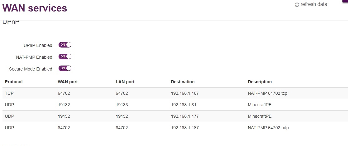

OK, the usual question. I am trying to access Plex via the internet from outside. So far no luck. I’ve read up on it quite a bit and tried a few things, no joy so far. Port forwarding won’t do the trick, it seems to be a double NAT issue and I’ll try to get to the bottom of it but thought I post on here at the same time.
First some info I guess:
I have a Technicolor TG789vac v2 MyRepublic NBN modem/router/WIFI gateway
When I don’t specify a manual port in Plex the router picks up the Plex Media Service request and configures WAN port 32400, LAN port 21040 to my address 192.168.1.167 without joy. If I port forward 32400 the rule is set manually by me but still no joy
Windows firewall turned off, Antivirus (AVG) turned off… no joy
There must be some problem in my gateway with double NAT and I am nowhere near technically literate to figure out what’s causing the issue. Any help would be greatly appreciated
Your ISP is using carrier grade NAT. Unless they are willing to configure a port forward for you on their end there is not much you can do without more complicated networking.
Could you attach screenshot of the port forward screen please - from the router
Could you also go to website canyouseeme.org and see if the IP address displayed agrees with the wan IP address on the router
Sorry just saw that you did include the port forward table entry and it is ok

Thank you for all your replies… So going by @Achilles reply I won’t be able to access Plex remotely?
I do have IPVanish VPN software installed, i might take it off just in case before resigning to the fact that I’m screwed :wink:
Is there anything I can do on this screen? Disable DHCP or something?
Unfortunately no.
