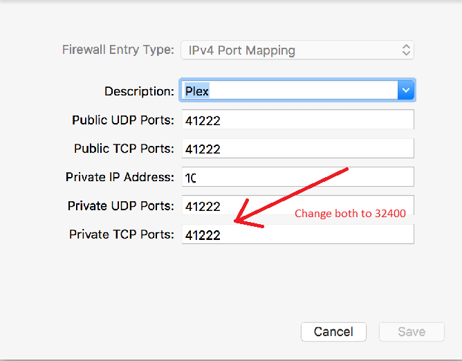

Change the “Private UDP” and “Private TCP” to 32400.
Click Disable remote access and re-enable it.
Should fix your problem.

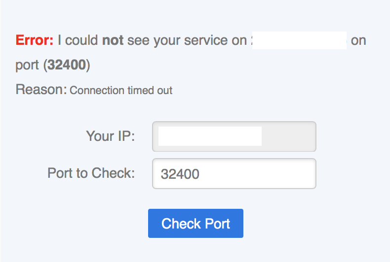

This is what I got after deleting the port forward and creating a new one with 32400:
It sounds like your port forwarding isn’t getting setup right or not working.
Do you have any other services you host you can setup a port forward for like a web server or something so you can test if your port forwarding is working?
Why is the Private IP Address in the screenshot for Port Forward wiped? There is no security issue with sharing the private local network IP Address
And is manually specified port ticked on the remote access plex media server settings page ? and if the Public port is 41222 then 41222 needs to be in that box and also in the canyouseeme.org test
And your screenshots that you linked here http://forums.plex.tv/discussion/comment/1509000/#Comment_1509000 are not accessible
You have a screen shot that shows private and public ports.
The public port can be almost anything you want to have, over 1000 and under 65K or there abouts. This is the ports seen from outside of your network. You specified 41222 in the screen shots so this is your outside port and the only port seen outside of your network. 32400 will never be seen outside with the rules you are setting up.
The private parts are internal to your network and for Plex to work right MUST be set to 32400. Again, this will never be seen outside of your network, unless you forwarded it. Any attempt to hit this port outside of your network will return an error.
Once you have this setup that way, you still need to go into the settings on the server and tell Plex what public port is used outside, so this can get published out to any clients you try to use remotely.
This needs to be done for everything to work right. Otherwise it won’t work at all, or work intermittently.
The NEXT step is to go to canyouseeme.org and try to verify the PUBLIC port is opened. Not the PRIVATE port (which has to be 32400, remember.)
The private port (32400) is never seen past your router (unless you have manually specified that port in the router’s rules. Don’t do this unless it goes to 32400 inside, too.)
