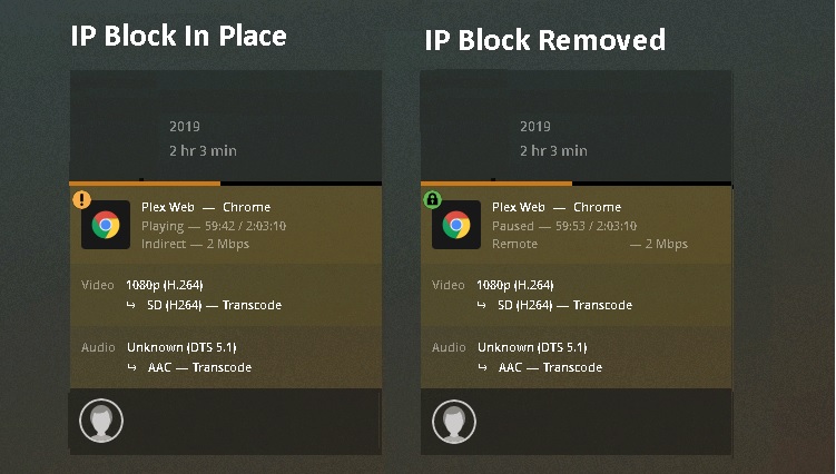

Remote Access - Repeatable Authentication Issue - Detailed Logs Showing Issue Provided
ISSUE: Plex maybe using systems in China to validate PMS systems. When USG firewalls – GeoBlocking China causes client to go to relay mode rather than remote. I have not confirmed that Plex is using systems with IP addresses in China (or the IPs being used were are known to be China IPs). However, there will be a follow up when a PMS is built on a network I can log better. – For now if you are blocking inbound connections from China or using a USG and are experiencing issues with remote users going into relay mode you will need to remove the block to address the issue.
[Details]
After a large and very time consuming amount of testing on various applications. This issue is repeatable, details of the process will be posted after this post, following an additional post of logs, and then old notes following this issue.
Here is the following possible conclusions for this specific issue.
The issue when using UniFi Security Gateway – When using GEO blocking and selecting China this will break Plex and cause some users to relay… The issue only comes up when inbound connections are blocked. Outbound (PMS network side) connections being blocked does not cause the issue for relay. (NOTE: This implies that Plex is generating a inbound connection to a PMS for validation, if you block that address your users could be forced into relay mode)
This issue could be caused by an IP range that Ubiquiti is pre-assigning for the Block that isnt China, or that Plex is using a server in China to validate a PMS. End users of the device cannot define the GEO block list for a given country… This only occurs when blocking China, additional country blocks are just fine.-- Because I dont have a syslog server for the USG I was not able to determine the inbound IP(s) that was causing the issue. I will need to setup a Plex server on the Palo Alto (for which I do have syslog server for) and see what inbound IP is needed to be whitelisted (follow up to this thread when that is determine… or perhaps Plex would like to tell us IPs we should be whitelisting,… i wont hold my breath on that). I would say it would be nice to have such a list, but given how fluid cloud networks are…might have to be a large range.

{Experience when blocking China} – Relaying is overly complex and appears prone to failure

WHEN USING GEO-BLOCKING CHINA ON USG

Note: The indication of Indirect vs Remote are on the same client, same browser.
The following logs provided show both the client side actions when an IP address is blocked. I haven’t actually reviewed the logs in detail yet… I’m a bit burned out removing all the identifiable data and there was A LOT of it. I’m sure I missed something, but should be enough provided

These logs represent both client and server side actions at the same time, should be somewhat easy to directly correlate and action on the client with the server logs.

Client Logs When No Block Is Place
I was too lazy to sanitize the server ‘no block’ logs. Here are the client based ones… One thing is for sure that whole relay process is very very very messy. By comparison the direct is super clean… the relay stuff looks like the result of spaghetti code one would find on a 20yr old MUD.
Client_IP-No-Block_REDACTED.7z (5.6 KB)
