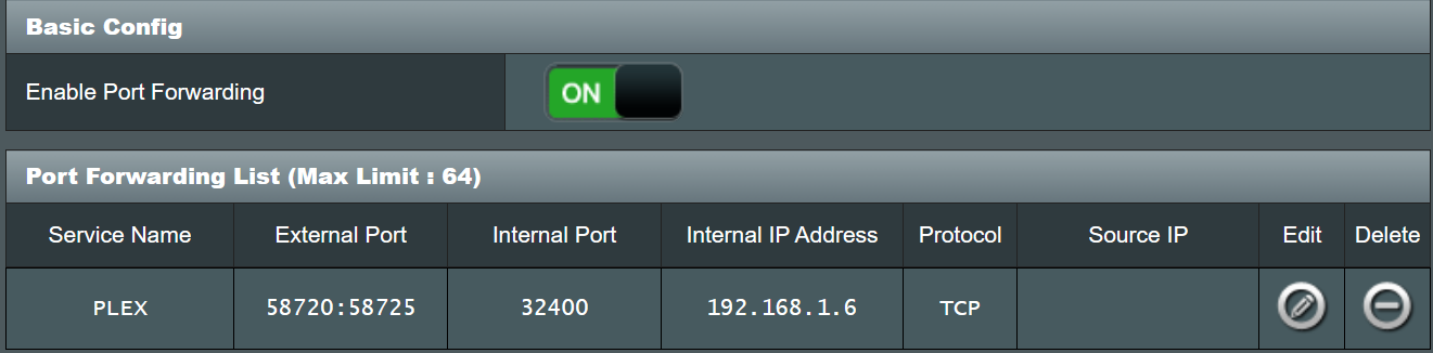

The Manual port is still active:
However, it no longer seems to work. I tried CanYouSeeMe.org - and it says the following:
Error: I could not see your service on 24.226.96.22 on port (58720 )
Reason: Connection timed out
This used to work and I tested it just before I went on holidays. So – not sure what else could have changed…
I note that the SERVER has its IP address reserved to 192.168.1.6 as shown above.

I had contacted the ISP yesterday and they stated that they did not block any ports. You might note that on the router I had forwarded a public range of 58720:58725. I had tested 3 different address in that range. When I change it in the Remote Access page, it works momentarily; and the on a page refresh it gets blocked.
Seems to me the ISP is sniffing ports and then shutting them down; but I don’t know enough about ISP processes…

@JaysPlex : The external (public) port range is 58720:58725. 32400 refers to the internal port.
I changed the router to be TCP only - rather than “both”:
I went back to 58720 on the Plex server - and that seems to be working according to Plex Server.

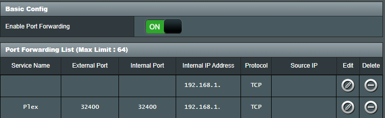

Hi, I’m having the same issue. Everything was working fine, and then this morning it all stopped. no changes on my end except a recent update to plex. Tried different ports, restarting plex and the synology it’s on, no love. Nothing new to add except I am also having this issue.
Yes, the default and only option for the internal port is 32400, I just meant to change the external port to 32400 also
Since the range you had was getting odd results with one number working and not the others, I thought to eliminate that part of the equation as a test
Got exactly the same issue. external 32400 internal 32400. I tried both TCP/UDP and TCP by itself. I have been using these settings for years and it is recently the external connection works once. Yes, only once and 3 seconds later it goes red again
