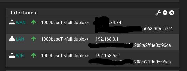

I have my modem (S33 cable modem) feeding my pfSense which sits in DHCP mode on the WAN interface. (one layer of NAT).
I’ve added IPv6 support to the LAN side and now show this which means I am fully Dual -Stack ready on LAN.
When the ISP drops IPv4 on WAN, I will be ready.

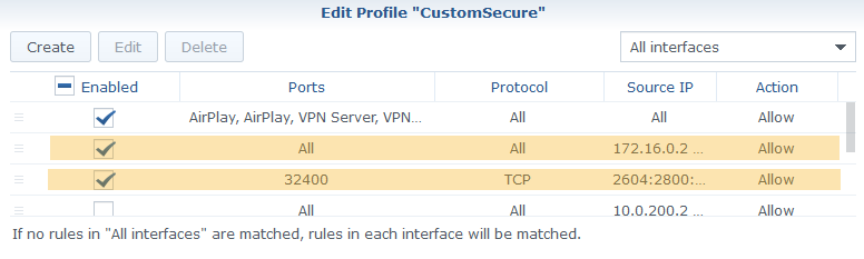

@Excel
Which syno do you have?
Did you open the firewall ports on the Syno? (if your firewall is active)
I got the DS1618+ (with RT2600ac router). I opened the ports both on the router and on the NAS since both have active firewall:
Router Firewall:
NAS Firewall:
@ChuckPa, I also noticed that both the Plex IPv6 and the IPv4 addresses in the Router firewall are not getting any “hits.” If you look at the Hits=2 above, that is all from running an IPv6 port scan. But attempting to connect to Plex remotely or even disabling/re-enabling Remote Access in Plex web settings does not generate additional Hits. So I’m assuming those requests never even reach my router? The router’s IPv6 address contains a section that is “XXXX::XXXX.” I have put this into Plex as “XXXX-0-XXXX” and I’m pretty sure that’s correct because when I did “XXXX–XXXX” without the zero, Plex remote access became red.
