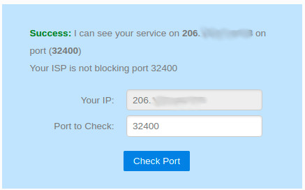

Above are the settings for server and the gateway as well as a port check. I have been messing with the settings for two days now and can’t figure out what the issue is. Any help greatly appreciated.
You’ve configured your port forward rule to use 32400 as the external port, but you’ve configured Plex to use 13269. These need to be the same value.
I’d recommend configuring Plex to use 32400 since canyouseeme already shows that your port forward is working. Change the value in Plex and then click “Retry.”
Also, the protocol for your port forward rule only needs to be TCP; it likely won’t hurt anything to leave it as both, but as a general rule you only want forward what is actually needed.
