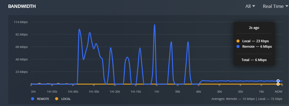

I tried reinstalling the plex media server. When I did I had my brother try playing something and it played it perfectly. He then restarted his client and the same 6mbps and buffering occurred.
The left peaks are what it’s supposed to be like, but the right peaks are what happens every time they try to play something off network (again, only for them, remote play works well on the VPS).
