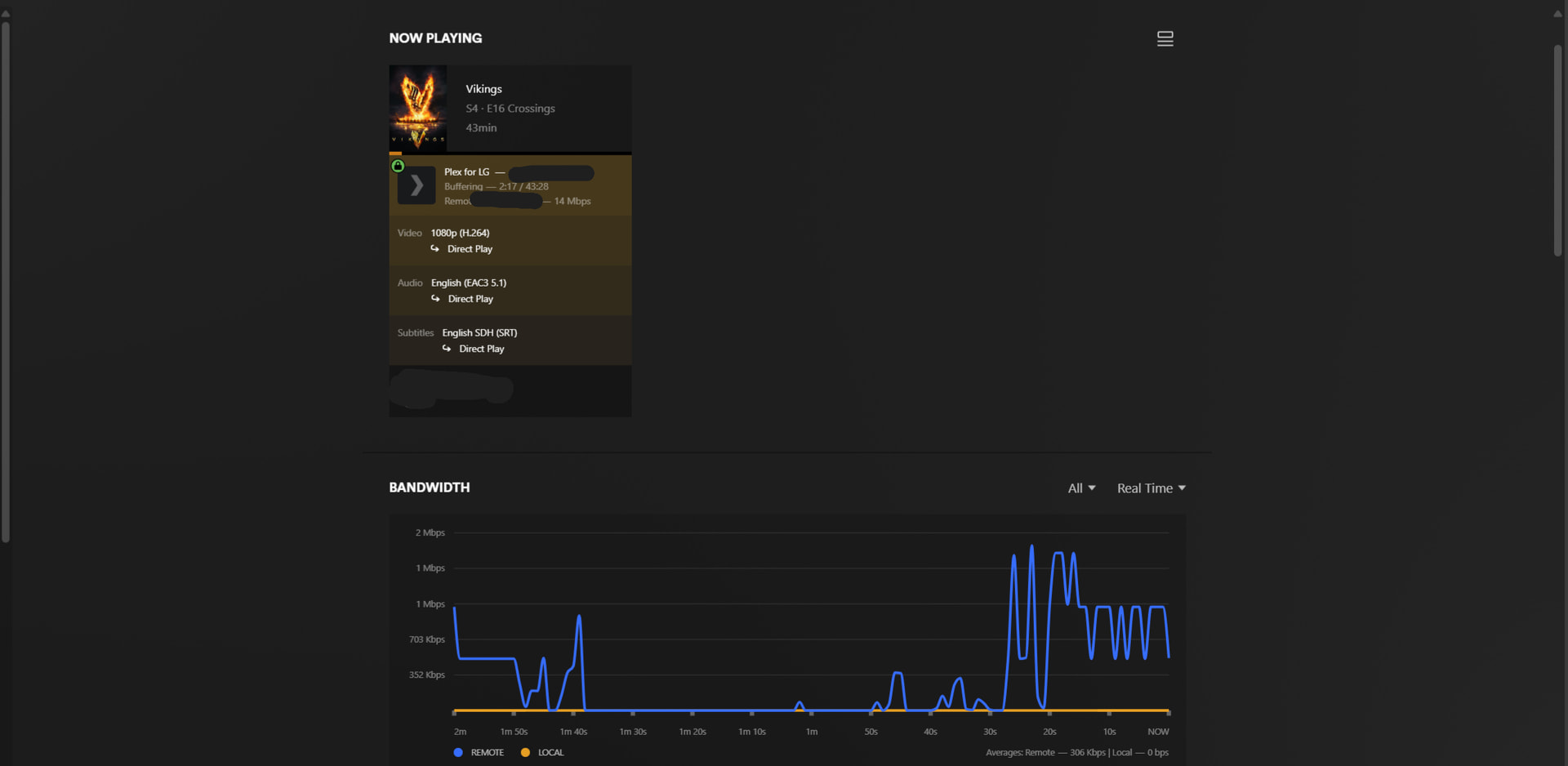

Remote play buffers randomly and starts throttling at 500kbps-2mbps
Server Version#: 1.42.2.10156
Player Version#: latest
This issue started about a month or a bit more ago. Remote Play does work fine without buffering on my end (Although I didn’t test for a prolonged time). The only user I have is having these buffering issues on their LG TV and iphone. Tried restarting router on both my end and theirs. I reinstalled Windows 11. Server connected with ethernet cable. I also tried on WiFi. We didn’t have any issues with it for 2+ years now. same isp. we didn’t change anything or any settings.
Subtitles are direct streaming on tv… idk if they always been like that or not. on iphone it’s direct playing.
in Authorized Devices, my plex server is stating Window 10 ( that’s what I initially installed it on before upgrading to Windows 11.. but it’s been over a year since I did with no issues.).. idk if it’s effecting it now?
Also in task manager it sometimes doesn’t display plex activities on my drives, but the stream is working fine without buffering… idk if that is another issue as well that can be related to this.
Edit: I forgot to mention we both have Fiber internet. My upload speed is 200mbps. They also don’s have issues buffering or any other internet issues other than on my plex.

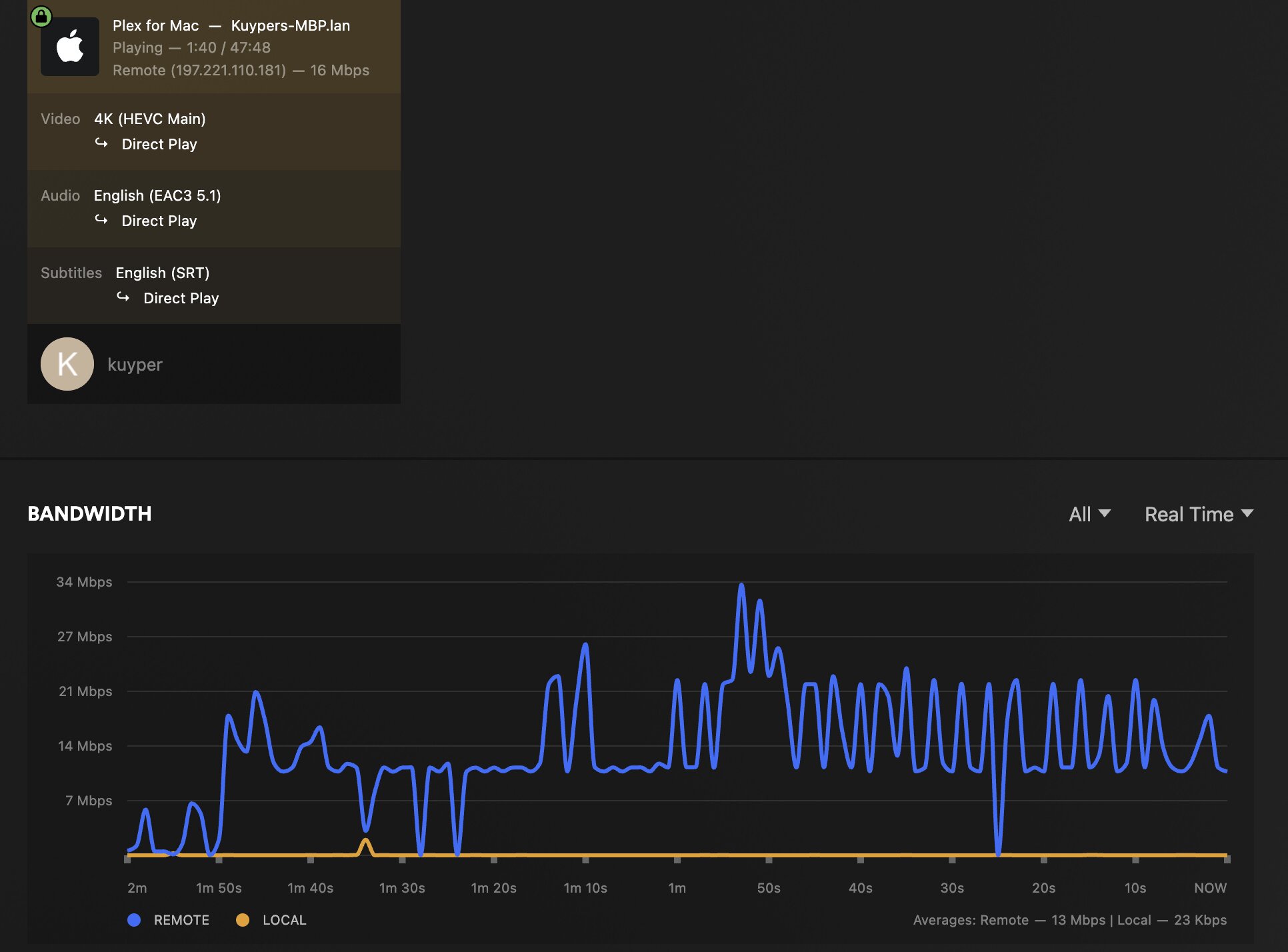

Seeing similar issues; currently out of the country; have tried direct VPN connection to my home server (WireGuard) - also tried going via my public port (both 32420 and some unused port <1000) - both of which are forwarded to my private.ip:32400
end up with this sort of graph:
but intermittent buffering - rather than “surging” ahead, and getting some deeper buffer, I have to pause the playback, let it build a deep buffer, and then watch (but it catches and passes the end of the buffer every few minutes. Tautulli reports ~16Mbps.
So, well above the 2Mibps in the thread title, but clearly not hitting close to the max possible to rapidly pre-fill the buffer
Native speedtest (even to a US Server in my hometown) shows that my ISP where I’m at allows ~80Mibps down, 60Mibps up (this all with VPN torn down, but similar results on VPN)
If I pause, I’ll intermittently get spikes up to native b/w
before it drops to zero (depth of buffer) - but as soon as I play, it starts falling behind, and soon I’m buffering again.
Server is totally unconstrained TrueNAS Scale
Latest PleX server (App Version: v1.42.2.10156-f737b826c Version: v1.2.20) and Client (PleX For Mac Version 1.112.0.359-0d79a49f) on M1 Max Pro with 32GB RAM (Tahoe 26.2)
Home network (where server is located) is Sonic Fibre 10Gibps symmetrical (realistically I can “only” achieve 5Gibps :slight_smile: ) - TrueNAS Scale Server is 10G connected to Ubiquiti Router, so that side is not the constraint either. And when I’m home, everything runs smooth up to 90Mibps 4K movies.
Using an HTML browser (Chrome) it’s pretty much unusable, but the official PleX App fares better, but still buffers all the time.
PleX App on the Mac is using ~14% CPU, system is 75% idle. PleX App memory is 1.6GB (yikes!) but I have plenty free (yeah, my Chrome chomps most of this on open tabs, but closing Chrome doesn’t help)
Mac Net usage maps correctly…
And nothing is being transcoded, but if it were, there’s a GTX1080 on the TrueNAS that would tackle that (but again, this is direct play at 4K to my MacBookPro)
Final look at PleX Dash graphs:
