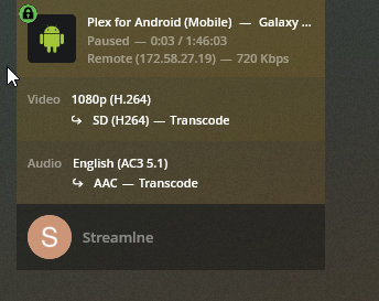

So I noticed that no matter what settings I set Plex to, users only stream at 1 mbps. Some have their settings set properly over SD streaming. I have 20 mbps up with unlimited bandwidth per client for testing purposes. Nothing changes
It also shows transcoding down to SD no matter what. Remote access is green with port forwarded

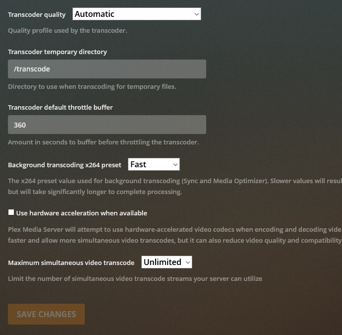

I am at a loss as to what to do next. Screen shots of settings below.

Just to be sure, I see in your images that you have the server set to "Limiit Remote Streams to original*, but is it also set to maximum inside the plex app on your phone?

There are two things that control remote client streaming quality/speed.
  1. The “Limit Remote Streaming” setting on the server
  2. Each client can set the quality of the stream as well, up to the server max
So what is your client set to?
My phone is set to 720 3 mbps
It initially streams at that quality then drops to this. I have a good connection
